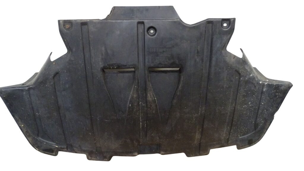

                  Originally posted by struikie
                  Happy that I managed to snag a correct under body tray.
                  JW
                  Hello mate,
                  Are you please able to tell me the part number for the correct under-tray for the S2 Bumper?
                  I am looking for one for my 80 Avant with S2 front.
                  Ps, it looks spectacular under there!
                  Cheers!

                    Originally posted by 89 Coupe
                    Hello mate,
                    Cheers!
                    Thanks!
                    This is where I bought it. They still have one.
                    Zustand: Gebraucht mit Gebrauchsspuren in Form von Verunreinigungen/ kleinen Kratzern möglich. Die Ware wird ungereinigt geliefert. Die Ware wurde geprüft und ist funktionstüchtig!

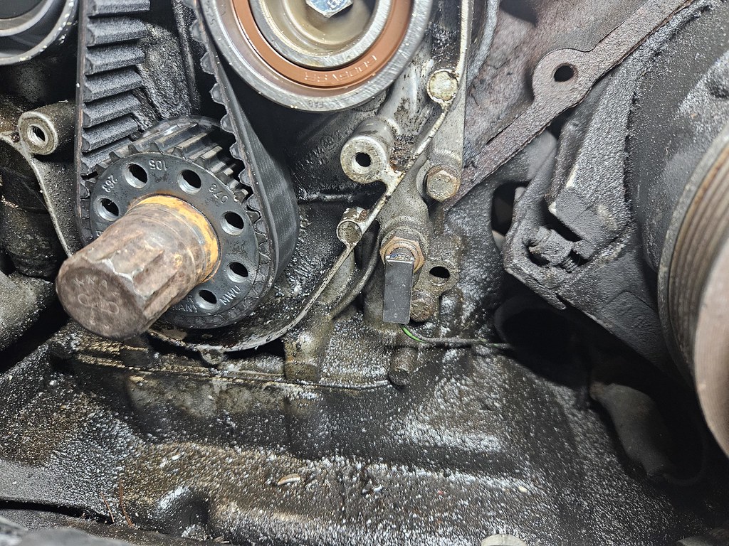

                      Water pump feels bad and the pulley is seized and out of place.
                      The timing is still OK, but the belt is loose. I hope I was lucky.
                      JW

                        Fitted a new cam belt, roller and tensioner and a new poly belt + tensioner.
                        Started the car and it ran fine, so no damage to the engine.
                        I do have a major oil leak at the front of the engine. I think the gasket
                        of the oil pump has failed.
                        Anyone have some tips and tricks on replacing that?
                        Removing the lower sump to access the bolts from below and removing
                        the bolts from the front should be doable...
                        JW

                              Car is now running again. Oil leak fixed. I suspect it was a loose bolt all along
                              because it was always leaking. When removing the oil pump, one bolt was
                              very loose....
                              Replaced the oil pump gasket, the front main seal and the oil pan gasket.
                              Also replaced the cam and crank sensor to fix a rough idle, but no
                              such luck. These ECU's aren't the most reliable so bought one to test.
                              The allen socket on the top bolt for the oil pump was rounded by a previous
                              owner, so had to buy a new one from Tradition. As the shipping cost are high
                              also ordered some trim I will need in the future, like the lower front grilles, rear
                              license plate holder and the upper door trim. Fitted a new crank bolt.
