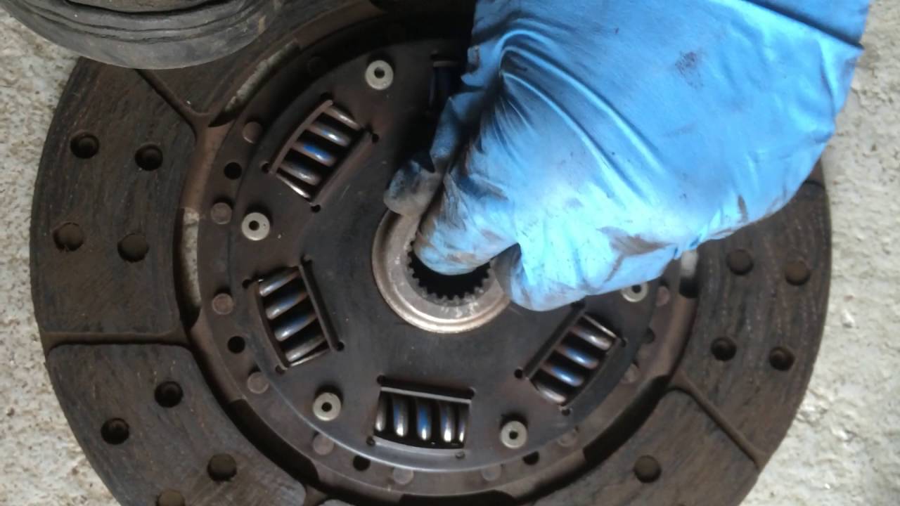

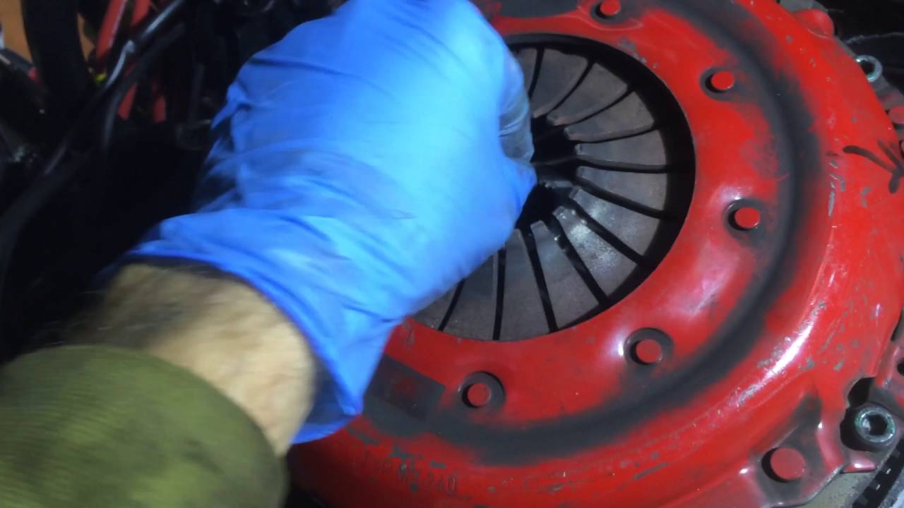

              A couple of weeks back I was getting an awful rattling on idle and which quickly developed into a horrible crunching feeling through the pedal when shifting.
              I'd had a little rattle on idle pretty much since I fitted the new clutch & INA metal faced release bearing about 5k miles ago.
              So I presumed the release bearing was toast. After pulling off the gearbox, th release bearing looked perfect - good news.
              What greeted me was less good news - my very expensive Southbend Extreme Street clutch disc was fooked. The drive hub was loose in the assembly and this was the source of the problem. It's not obviously worn so I put it down to poor construction.
              I decided to get a new Sach Race Engineering disc which arrived earlier this week. Also some new Lemforder diff mounts to join the party.
              Interesting to compare the two friction discs side by side. The SRE unit has MUCH better build quality - to the point of being incomparable. Every component is significantly more robust and is of better quality, right down to the rivets.
              There is no way in hell this Southbend unit would sustain the torque they claim (500lbft+), even if it could generate the friction to hold it. The irritating thing is I could / should have bought an SRE unit in the first place but the Southbend came with good reviews and claims to hold a fair bit more torque - they do say that a fool and his money are easily separated.
              Moral of the story - don't believe the hype and go with proven high quality parts.

                        • I am wondering if the clutch kits sold by aftermarket companies are using very low quality materials on the lower grade torque levels and the proper ones on higher torque levels.
                          My southbend kit is still holding strong and in fact when I thought it had gone only to be the pump I have a second kit unopened and unused sitting in my basement. From memory I had the kit to hold for 800ftlbs. Is it the double metal faced one or something..?
                          • That's what mine was supposed to be. It was the highest rated one without getting a puck type disc.
                            Personally when I buy from an independent and pay proper money, I expect higher quality than a mass produced product.
                            • I agree. My disc has springs and designated for a single mass flywheel. I remember mine was the last before going for a 6 or 4 puck.
                              It's difficult to judge but at least mine has lasted quite a while
