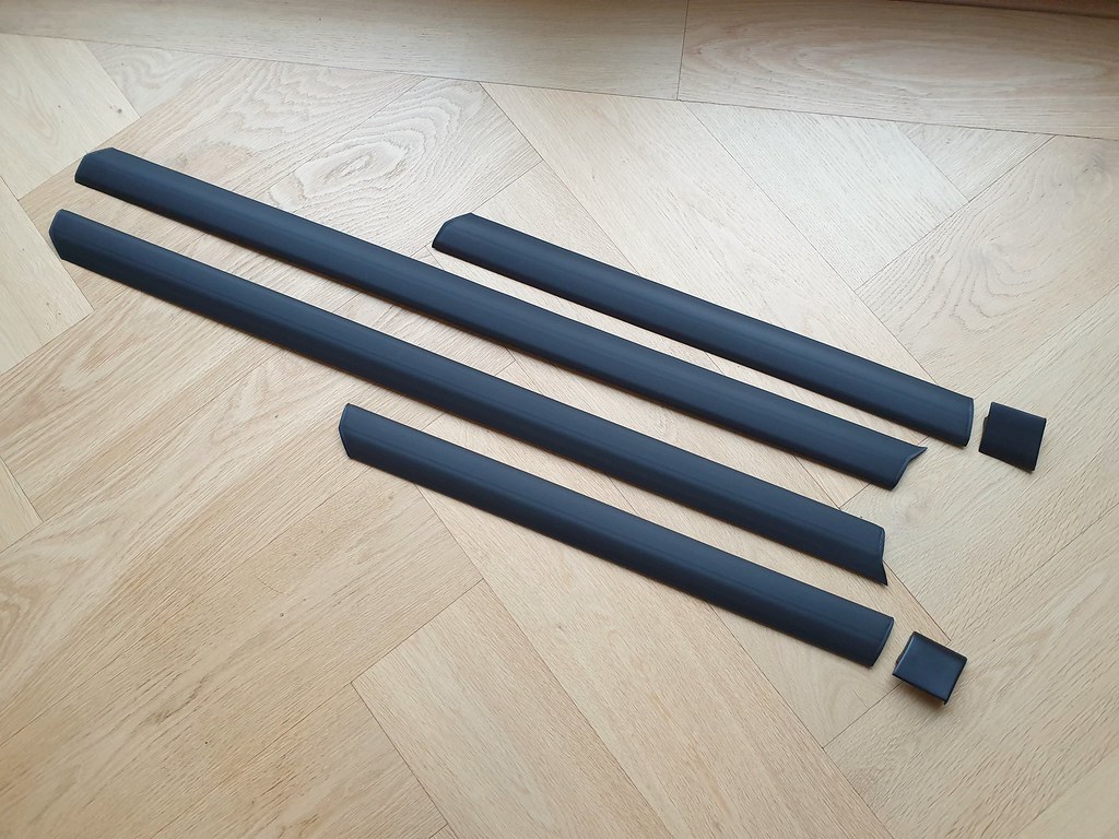

          • Slowly gathering stuff...

              • Originally posted by struikie View Post
                JW
                Hi struikie where did you get the small exterior trims from please have you got the p/n for them, I’ve swapped my v6 trims for the skinny trims like yours but couldn’t find the p/n to the smaller trims regards Michael
                • Also interested to know about the lower trim, take it they are rs2
                  • Part numbers are here: https://www.s2forum.com/forum/techni...56#post2130456
                    Got the door trims from Autewo, but I don't think they sell them anymore.
                    The small rear trims I got from the German Kleinanzeigen through a private seller.
                    The small front trims I couldn't find anywhere so I bought reproduction ones from https://www.fs-construction.de/produ...uenne-version/
                    JW
                      JW
                      I thought so,do the trims from fs- construction fit good I know there plastic.
                      • I haven't tested the fit and it will probably take a couple of years before I end up
                        having the car repainted and the trim fitted.
                        JW
