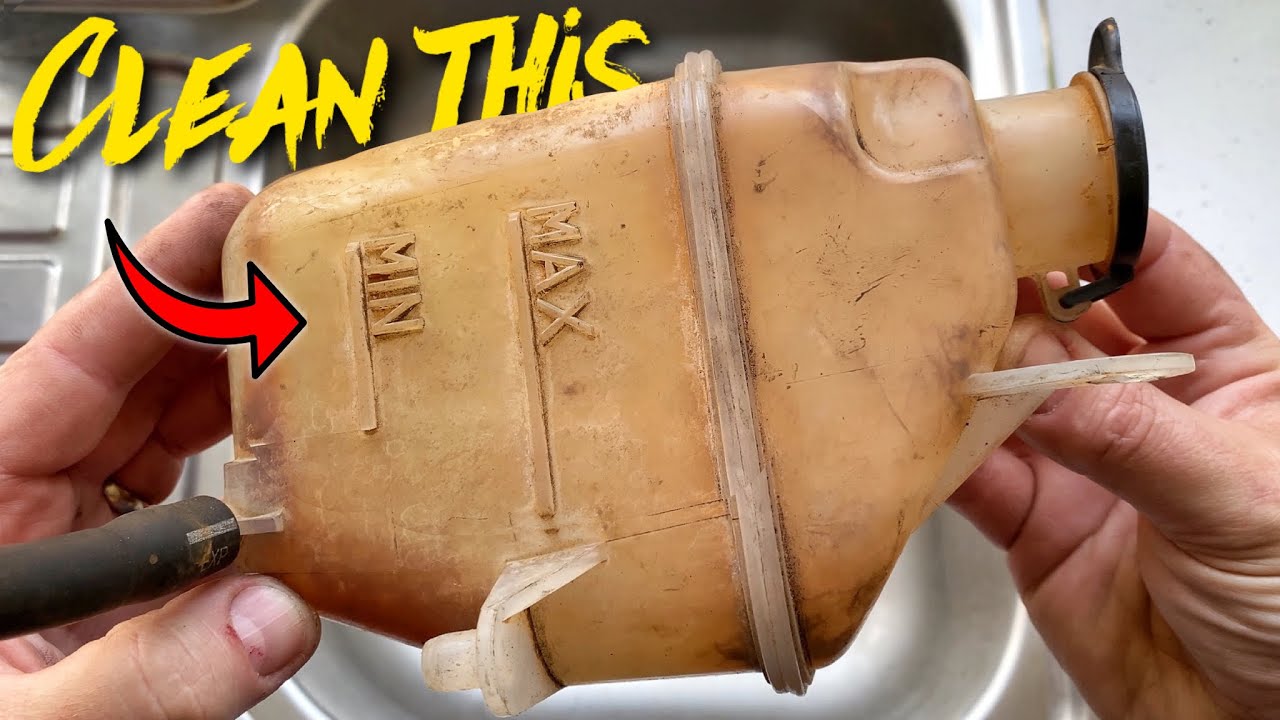

          Pipe looks good. Have you had a go with the sulphamic acid yet? I'm interested to know how well it performs on the expansion tank.

            It's been soaking for three days and it's still brown

              That's disappointing.
              Well, how about this :

                Nice. Bleach was the first thing I tried but not with washing up liquid. I will try again

                  I would probably try some wheel cleaner/fallout remover. The sort that reacts with iron particles. The brown stuff is most likely rust/iron from the block. Good luck, and great project (as always)

                    Bilt have detailing bottle that deals with iron particle I think so try whatever Bilt rust remover you were soaking the pipe above in.

                      That's next to try then as the bleach mix has done nothing.
