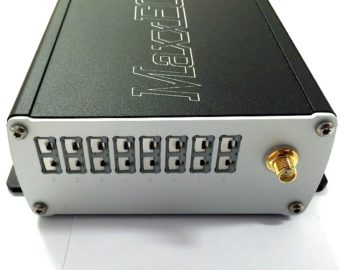

                    is the maxx ecu equipped with so many EGT connections or are you going to use a distribution box so you can read one egt at the time or maybe a seperate egt display?

                      Alex, it will depend of how my challenge with the IM turns out.
                      Nick, yes the Maxxecu has direct inputs for multible EGT's, and you can get all readings out on the Mdash tablet screen for visual inspection.
