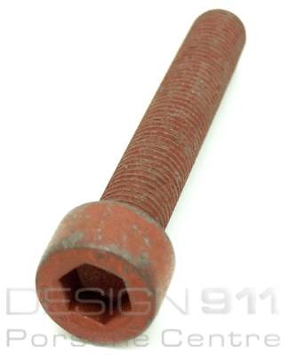

                        The proper Porsche bolts arrived and I fitted them no problem. There are a little long but don’t cause any issues.

                          #612
                          Hmmm, those are not the OEM caliper bolts. Are they the correct grade? (min 10.9?).

                            #613
                            Yes, 10.9. Got them from 911 design. They are meant to be OE Porsche for 911. I paid £30 for the four including postage!

                              #614
                              Hmmm, but there is no shank on them!
                              Not what I would have expected.

                                #615
                                https://www.design911.co.uk/fu/pt66_...--Disc-Screws/
                                Brake Caliper Mounting Bolts. Porsche Various Models
                                Code: 99906704209
                                Brake Caliper Mounting Bolts. M12 x 1.5 x 77. 2 x Bolts required per Caliper, Fits front & Rear Calipers.
                                Geniune Porsche product.
